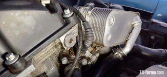

Well replaced several months ago, looks like it hasn't lasted long.
Oil over drive belt, alternator and running down to the belly pan.
I am assuming the seal has gone, again.

flybobbie said:
Well found the problem.
See it running out.
Could try re-torquing and see how it goes.
Doubt it very much..
On Monday go local dealer, get new O ring and some new bolts and fit.
Not messing about.
Oil is running out and dripping down engine running.
Ordered a new Gates drive belt, have old one i kept to fit for now.
Seal already on only several months old.
New seal fitted.
Buy cheap, buy twice....
Can be seen the seals are different.
BMW seal (top) has little bumps to centre the seal before clamping.
The cheaper after market hasn't.
Bottom cheaper ended up with a slight twist i assume causing the leak.
