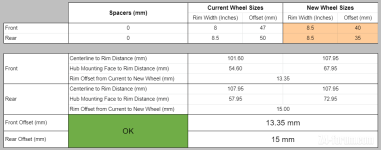

With those wheels (and based on a standard staggered setup of 8x18 ET47 and 8.5x18 ET50) you would have 8.35mm more front protrusion than stock and 17.7mm more rear protrusion than stock.
I would therefore suggest maybe going for around ET40 at the front (if you can) to bring the front out to 13mm protrusion. You will want ET45 for the rear as 17.7mm is a pretty typical spacer choice (some go 15mm, others go 20mm).
Bear in mind, my little calculator above doesn't take into account inboard protrusion (ie potential clashing with damper tube).

If I was to go with a square setup - so 8.5 all round - would would that tweak in terms of offset requirements?
8.5 all round means the advice for the fronts above will stay the same (somewhere around the ET40 mark). The rears would probably need to drop to ET35 or even ET30. The picture below shows what it would be like with front 8.5 ET40 and rear 8.5 ET35.
Basically, on E85/E86 with M-Sport suspension you are aiming for around 12-15mm front protrusion from standard and 12-20mm rear protrusion. If the car has been lowered (Eibach, H&R or otherwise) then I've seen about 12mm at the front is the most you can go to on 18" wheels before rubbing occurs at full lock.
