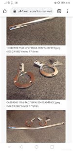

You'll also need to shave a bit from the strut mount on the m3 brace, this stops it from fowling the bonnet. Think I have pictures somewhere and will post later
If you don’t want to remove the camber pins then just file/cut them down a bit as I did. The camber pins are only there for easy of assembly at the factory.

Here's the OEM Z4 strut brace which shows the sections you'll need to file away to stop it fowling the bonnet
