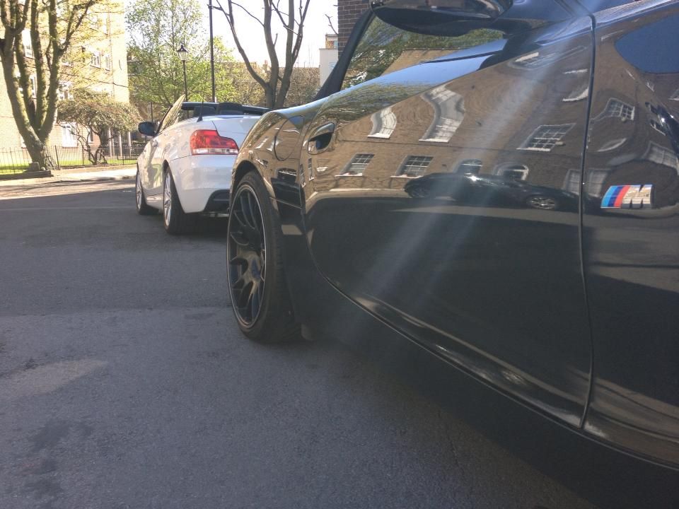

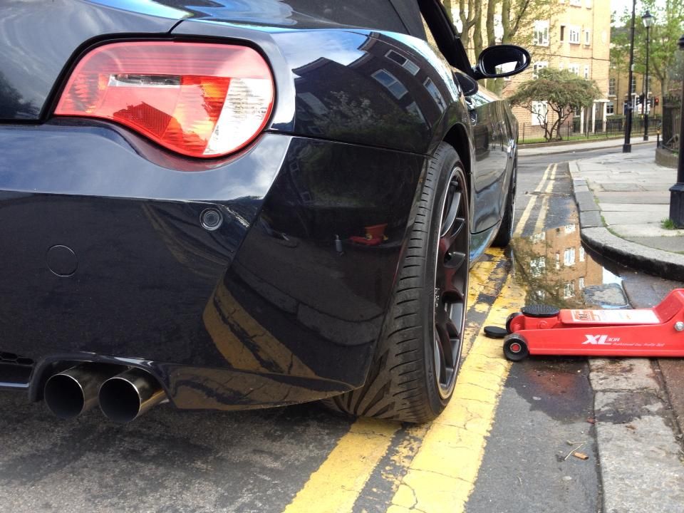

Seems odd that a 10" ET20 rear (BBS CH) fitted easily with no rubbing but a 9.5" ET27 with a spacer probably won't...
From memory I reckon a 275 would have fitted and there was plenty of gap between the tyre and the arch as the pictures show.
I'll trail fit the 12mm spacers on the rear once I get the tyres fitted and see what happens.
What tyres are those? Tread looks nothing like contis, pirellis, michelin?
