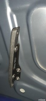

I'm in the process of retrofitting the OEM windbreak, including the boot lid brackets - and it's those that have me puzzled!
There are rectangular holes where the fixing screws should go, so I assume they're for quicknuts or cage nuts. M4 cage nuts fit the holes perfectly, and I assume that these would normally be fitted from the rear of the panel - but there's not enough room between the framework and the skin to get access!
I can fit them like this:
but a) it looks a bit naff, and b) it makes the windbreak stick out further down into the boot, and therefore possibly more likely to be damaged by the boot contents. My backstop it to design and 3D print some custom nuts, but I'm keen to see what the standard fittings look like first!
Thanks in advance.
Thanks for the replies guys. Zulu4 - from the photo the bracket should indeed sit flush. CE277 - thanks, it would be good to see photos when you find them. I guess they must just push in and fit snugly enough not to pull out when the screw is tightened.
Aha - I've found a photo of the official retrofit boot bracket kit:
So I now know what they should look like, and they should be really easy to design and 3D print.
