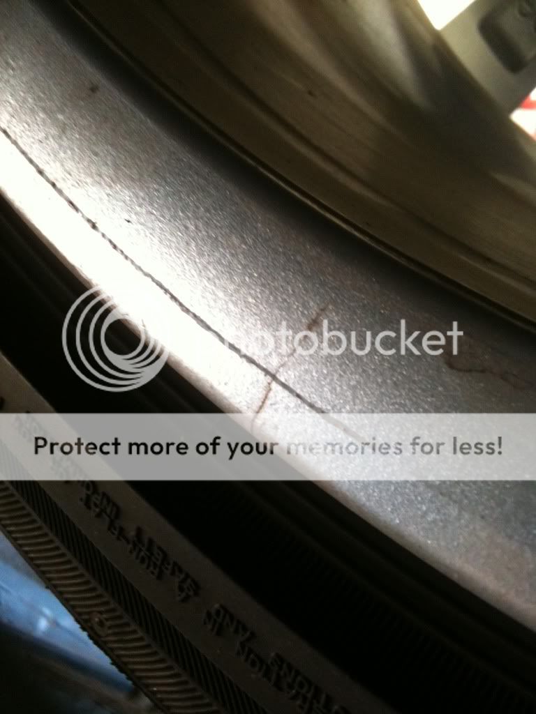

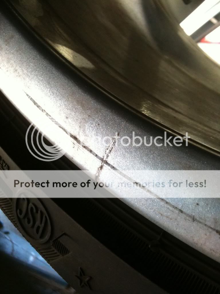

Hi Guys,
I recently purchased my friends 2010 sDrive 35i (he traded up to a Ferrari California) and i'm loving just about everything to do with with this car.
I got on the boards and had a read when I noticed reoccurring posts about cracked 296 wheels! I took your advise, and over weekend dropped off and
inspected my wheels only to find that BOTH rears are cracked. This is a car that has only done 14,000 km's in 18 months and not driven hard at all.
It's all very disappointing :cry:
The car is now with BMW Sydney so here we go. I'm ready for a fight as I feel this SHOULD be a warranty issue and after what I've read here
it is certainly a known issue. I'll Keep you posted and let you know how it turns out.
Some photos for you
Right side:
http://gallery.me.com/jamiebuckton/100093/IMG_0318/web.jpg?ver=13121723350001
Left side:
http://gallery.me.com/jamiebuckton/100093/IMG_0321/web.jpg?ver=13121723470001

With the cracks shown in the above photos does this cause them to lose pressure?
Bazza
Hi Bazza,
No, the wheels haven't been losing pressure. The only reason decided to check the rims was the repeated posts on this forum complaining
about cracks. Really glad I did!
J.
Good News,
BMW Sydney have just phoned to say BMW will replace the rims under warranty :thumbsup:
The only down side is that the two rear tyres need to be replaced at AUD$650 ea.(£430.00 ea). Had
expected this as the wheel alignment had been out and the inside edge of each tyre was completely
worn. Still makes for an expensive trip to BMW.
J.
