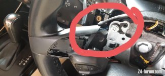

My '03 E85 has a non-M steering wheel (recovered) with flappy paddles (SMG). The paddles are actually just 2 switch units that are screwed directly to the back of the steering wheel spokes, not mounted on a slip ring as Usel says. I believe this is the identical set up used on some Zeds with auto boxes. A couple of photos of my wheel/paddles :thumbsup:20210811_205805.jpg20210811_205756.jpg
The paddles are screwed to the steering wheel on my automatic car.
