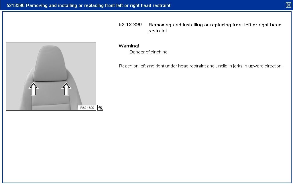

Does the headrest actually come out?

The headrests don't appear to be removable, part of the main seat. My passenger one can make a little tapping noise when going over rough ground as the seat is shaking about, but no creaking etc. Unless as others have said, its from the back rubbing against the bulkhead. My seat is about an inch away for that reason.
