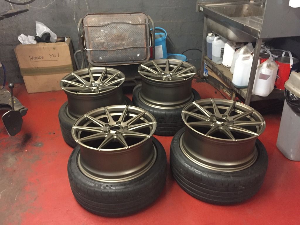

What alloys are they? They look lovely.
Yeah cheers man, they are bola csr wheels 5x120 8x18 et40 and 9x18 et42 I'm hoping they will fit on the Z

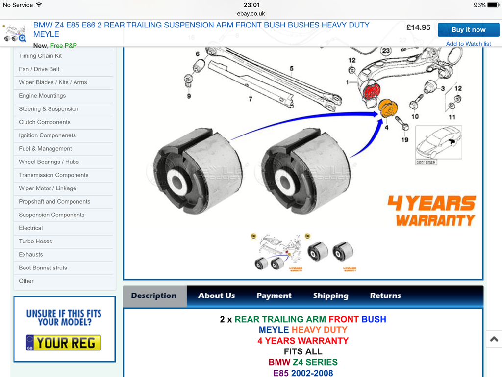

So, got my z4 home, didn't miss a beat all the way up the road really like driving it but I'm gonna have to get it into the garage and get the steering/suspension looked at.
Once up to speed the steering fealt a bit vague/bit of play in steering wheel, then when going round corners the back end just do didnt feel planted at all. I'm assuming this is bushes the p/s rear wheel looks to have some camber issues.
Any advice on what the common culprits are?

I got the Meyle HD Wishbones and Lollipops along with a set of Goodyear Eagle F1 Asymmetric 2 and the Hunter Alignment. Sorted out the light front end / vague steering feeling.
Car feels more planted.
Thanks for replying, only a tank and a half to get home, was showing 40mpg on clock, really impressed for being a 3ltr. What's lollipops??
So the rear bushes are shot,these ones.
But obviously will be changing the rest of them as well, i suppose euro car parts yeah?
Cheers bud got your pm yeah I think I'm just gonna go with oem style
OE are a faff as you have to install with preload. Get some poly - they have limiters built in and will transform the rear end. Biggest difference I noticed.
CP4Less had them for about £40, you need a tool to install and I got new nuts and bolts from BMW.
