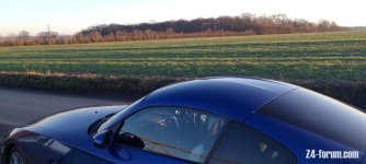

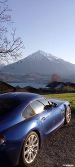

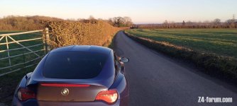

Hello All!
I got a few months ago a 3.0si coupe.
I recently took a massive trip from the UK to Switzerland! I really enjoy that car. I did before the trip the oil, oil/air-filter change before the trip. I also changed the front lights (as they had a burn mark, but I'm not sure what happened) with some new angel lights (which look even nicer).
