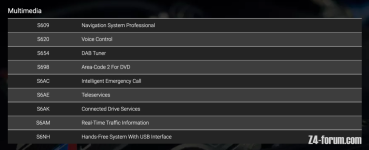

Not entirely sure what I should be looking at so have added screenshots. Would you mind taking a gander please. Have added the Multimedia section along with everything else. Thanks!

There's basic Bluetooth for calls, then theres enhanced Bluetooth which allows you to stream audio. Just another way of BMW taking your hard earned cash!
Hi! Yeah thanks. I've just been digging a bit more and finally came across a video explaining the two different Bluetooth options like you mentioned. Seems there's a work around so will give that a try. At least my head scratching can stop now :D
