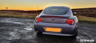

Evening All
I have recently purchased a 2006 - Z4 Coupe 3.0Si, and want to say Hi to the Community.
I live in West Yorkshire, and would like to get out n about on some meets in 2022 :)

Hi and welcome.
Lovely looking z.

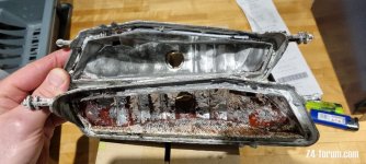

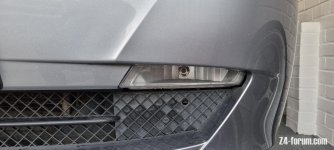

In other news, I have fixed the foglights which were full of condensation, by removing the wheels, removing the foglights from their housings, soaking in a Bucket of hot water & using a heatgun to pry apart. Then using a wire wheel brush I cleaned the housings up and sprayed them silver, I have drilled 4No 4mm holes in the bottom of the lenses before gluing them back together.
Looks right as ninepence na

Fog lights - Good job but many have got rid of the fog lights as they continually "fog up" and they have replaced with blanks which you can get from BMW at a decent price .
