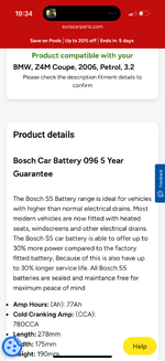

I’d understood that this battery was sealed, but I was in a bit of a panic and a rush when I looked into this and bought it. It reads so online looking again tonight having seen this.
My car lives in a garage away from home, I’ll be there tomorrow morning to go check for any vent holes now, I’m worried ! I’ll get back to you on this!

That's an AGM I'm sure of it? S5 is AGM, I think S4 is std?
It has a similar code to the AGM, but isn’t. I had the AGM before that and it didn’t last long, badly treated by me as I let it discharge and they definitely don’t like that.
Just as a folllow up if anyone finds this in a search, non AGM is ok. Don’t forget to take the bung off the battery transport terminal cover to plug one vent, and as per the photo, don’t forget to plug in the vent tube which takes the gasses out and under!
