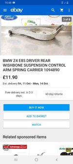

Thanks guys it's the offside that's damaged would this fit its e85 but I have 2006 e86
It's the same part number for all e85/86 models - even the M - but that part number in the photo isn't found on the RealOEM site.
