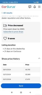

Cargurus.co.uk shows how long a car has been for sale and shows any price changes. Which can be useful for negotiating a decent price. It's definitely a buyers market but not all sellers have set realistic asking prices.
