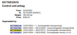

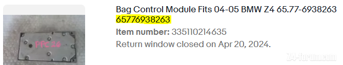

Last year I replaced the shorted airbag module in my 03 and I need help correctly programming it.
Superseded part
