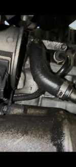

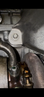

Ever since ive got my 28i z4 theres has been a leak around the turbo area and everyday theres good amount of oil on the ground. The leak gets worse when the engine is on and when i move it in my driveway a couple feet theres a smell of oil, interestingly the oil is still at max after idling it to operating temperature since i cant drive the car properly on the road i hope the sensor aint buggin with me. My suspect is the turbo oil feed line since i know its common place for a leak but when i recorded to pinpoint exactly since i cant see without the camera theres was excessive amount of oil on what is seems like a clamp on the turbo. Im just getting into the n20 rabitthole so any ideas of what exactly could cause the leak would be appreciated. Since i cant include a video this is the best photo which you could kinda understand where its leaking fromIMG_1280.pngIMG_1279.png
