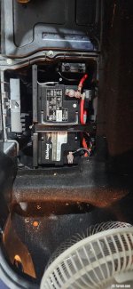

My 2005 Z4 Car speakers started cracking while driving then sound stopped all together although radio was still on. Got home turned the car off speakers are still cracking like crazy. I don't know what to do. I did find water in the battery compartment and soaked it up with paper towels. I have a fan blowing into the trunk now. Should I unhook the battery? I'm afraid because of the water that was there something might be shorted and cause a fire.
