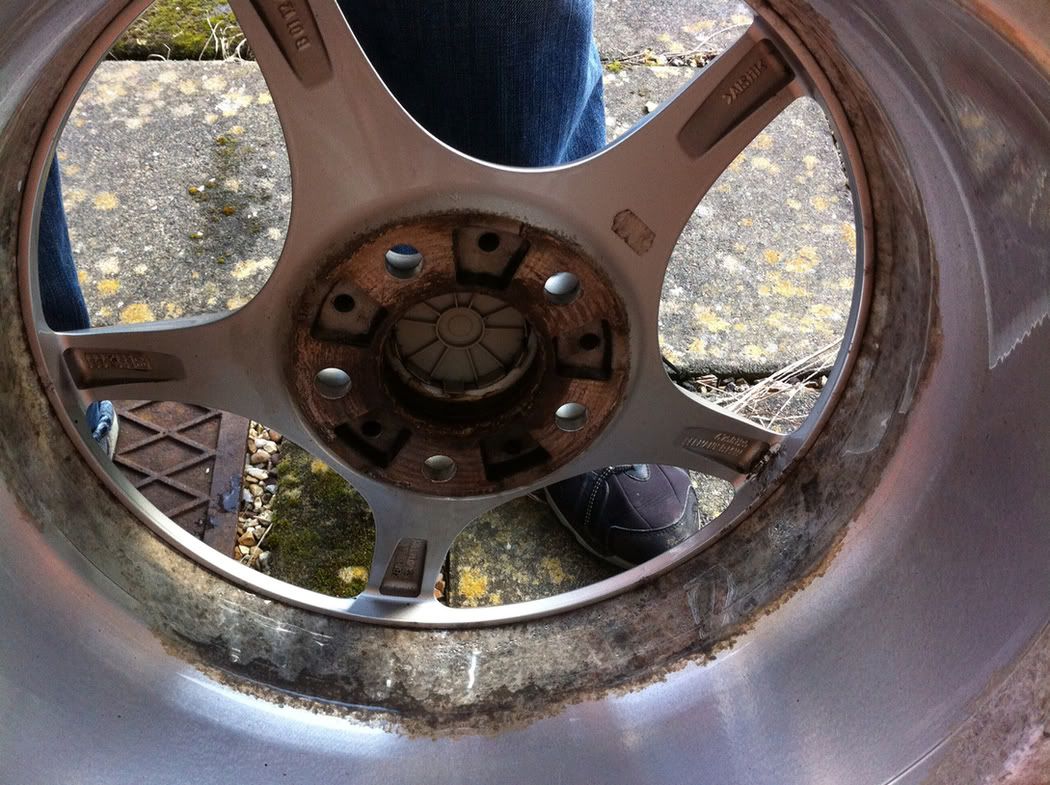

As they arrived - no curbing just corroded.

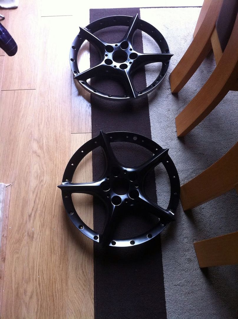

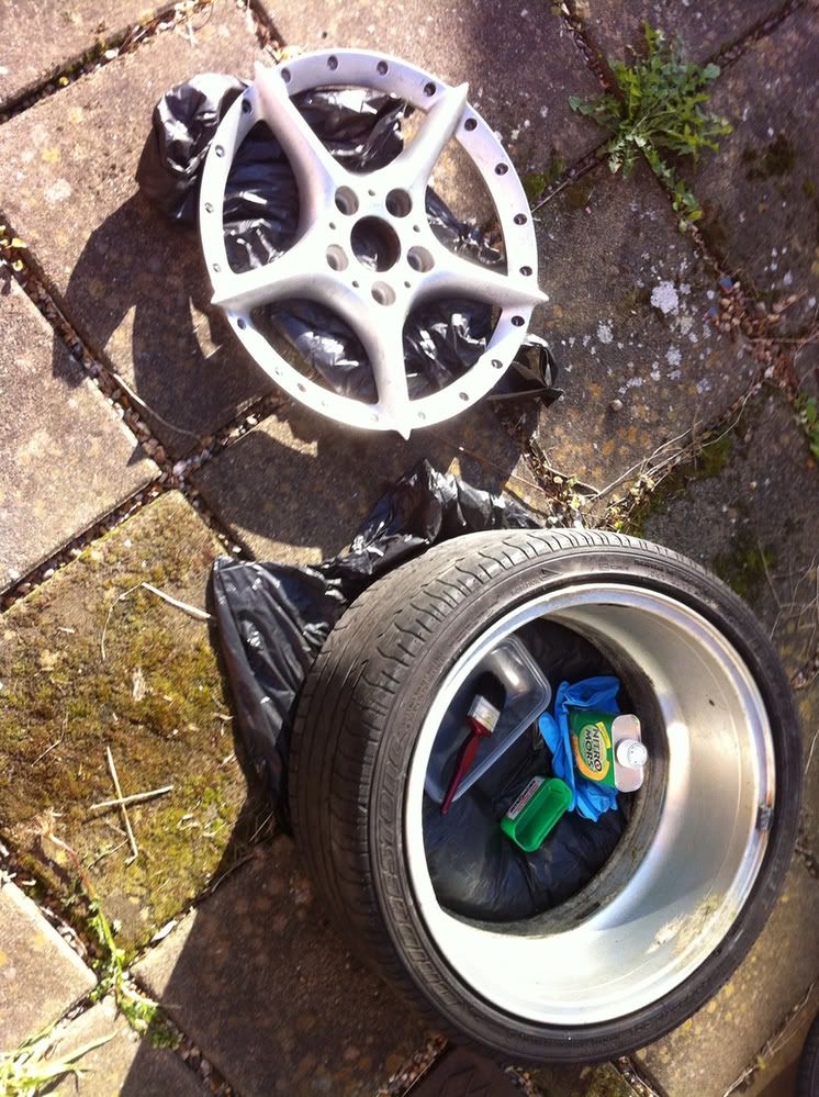

The first set split
I gave up on the nitromors And used a prepping tool which attached to the drill

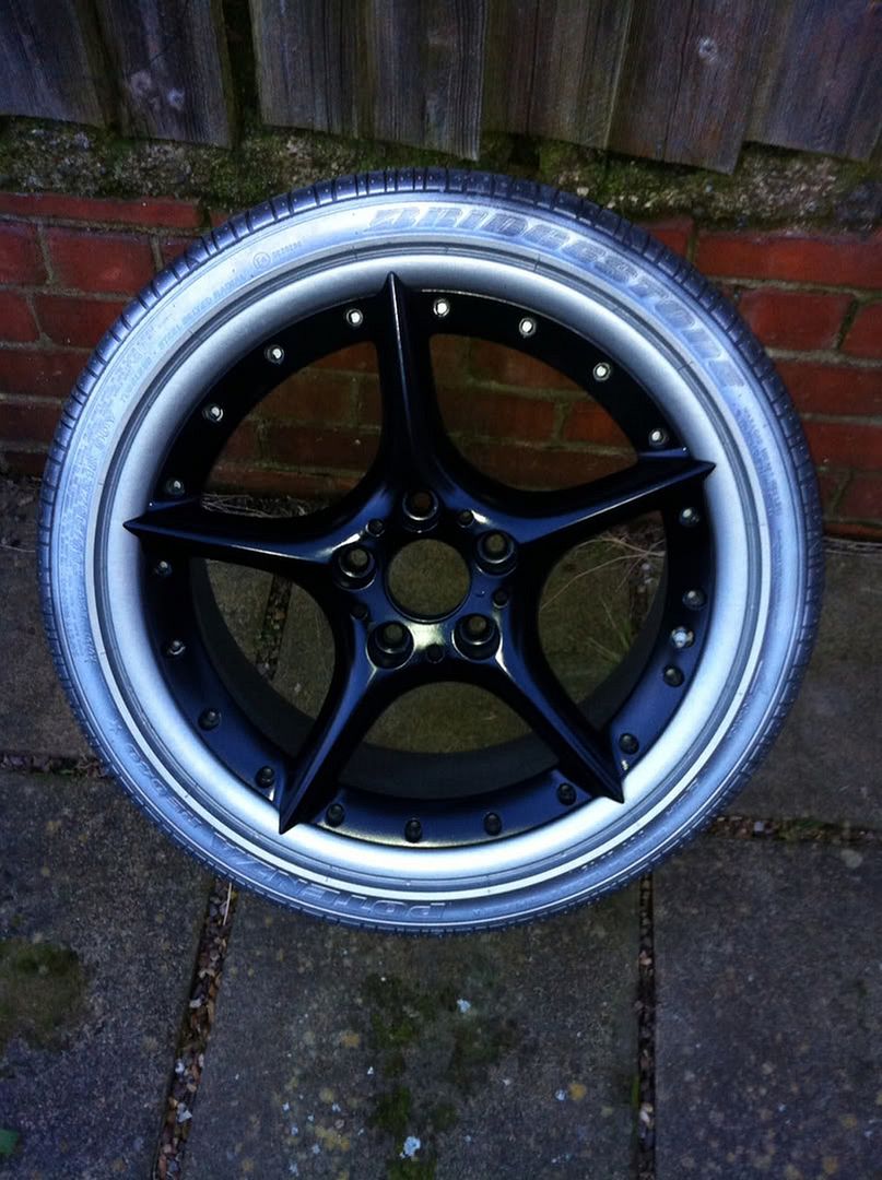

The first one done:
The rest are much the same!!

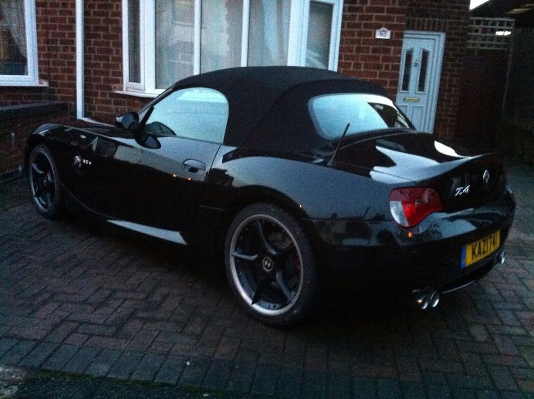

Got dark after i fitted them so just a couple of quick fitted pics
Nice refurb, I've only managed to finish three! I decided to put winter tyres on the standard wheels so gave myself the winter to finish the 108's. The trouble I'm finding is that I'm getting more picky with the quality as I go through the wheels, the first one may need to be redone :rofl:
Andi.
Thank guys :thumbsup:
Took it for a spin must say i quite enjoy the ride of 18's over 19's .
A bit quieter and slightly softer.... I went from 18rtf to 19's so never had the Z on 18's without rft's before :)
aquazi, nice :thumbsup: :thumbsup:
Having seen Adamski's in person, and now your photos, I am tending towards having mine split colours when they need done....
I was never too keen on the black centers... But then after i prepped them i realised black would cover imperfections better :lol:
get some of those dark rear lights and you could almost pretent to be night rider :) .... esp as when you press the sport button the revs will increase and you will shoot off like the turbo button :)
they look really good

inkey$ said:
Looking sharp Aquazi. What tools did you use on the drill?
I got two of these.... Each one lasted about 2 wheels.
http://www.screwfix.com/p/surface-preparation-wheel-with-arbor-100mm/31074
Dusty and noisy as hell though... But on a high speed drill strips the paint quicker then nitromors ever could.... Infact nitromors barely made a dent to the lacquer on my wheels.
