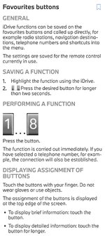

Finally not related but is there a way to clear/unassign the iDrive shortcut buttons? Holding 1&8 together doesn't seem to do anything?

Firstly the last bit, radio buttons.
Directly from the manual......

Regards the shortcut buttons for the radio - you don't need to hold #1 & #8 to reset anything. Reprogramming is as simple as going to the thing you want & holding in the button.
No idea how you might clear/reset to nothing though.
