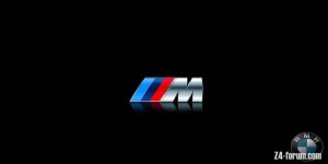

I found this on a M3 forum and thought it may be of interest for anyone with the later unit.
Link to update file, this has the mr12volt boot logo and the file to update the p2000
and a ” ///M” boot logo below
Personalised Boot Screen:
Don't use the sd card slot, use the usb dongle that you likely wired into the glove box. The newer unit (Model No: P2000-CICMD) does not use a password.
Instruction for changing bootup logo:
The above has a sample custom image (///M logo).
The boot logo file in that zip file should be replaced with either the one provided or the one you create following the instructions below.
If you use your own just remove the .jpg from the file and add to the USB stick, and the update file from Mr12v.
