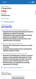

Evening Gents, I want some advice on what parts I need to supply them to my local garage to save some money. I have found a pair of bilstein b4s on eBay new for £83.50. However I’m not sure on the bits that go with it. I found some febi bilstein bump stops but can’t seem to find a supplier that sells the top mounts with all the little bits that go with it. Any links or advice on the right parts would be appreciated as I don’t want to book it in and it’s missing some parts! Cheers.
You just need the shocks. The rest of the bits, mounts, stops etc are maybe nice to do but probably not necessary. I didn’t change any of it when I did my shocks. It’s an easy DIY job buy the way.
Thanks! I thought being a 2003 it would need all the other bits with the shocks. I’ve ordered the shocks on eBay.
