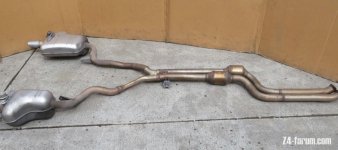

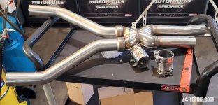

As part of improving the gas flows through the engine I’ve bitten the bullet with this German Fox stainless system with lovely big collector pipes, a nice large mixer and some polished stainless cans with bazooka exhaust tips…
Will be interested to hear how it goes with no ‘quiet’ exhaust flap…. :tumbleweed:
Picture of stock 35is collector pipe for comparison..
So yes a 35is has a noisier system than a 35i but the system is still gelded by the crimped collector..

So exhaust fitted and a quick test…in part limited by a front left hand buckled wheel..but that’s another story… :tumbleweed:
Nice sound..at low revs quite baritone without being a drone..higher up like a nice brass trombone…wind noise in the cabin overpowers the exhaust note so will have to wait till others hear it…
Didn’t realise that the OE exhaust system is all in one piece from the primary cats back….a bit if cutting n shutting required..
Interesting to why BMW put such a restriction in the right hand pipe that’s only opened at times in sports mode..
