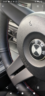

I took mine apart, rubbed them down and applied a few coats of Halfords matt black. Easy enough job and only costs for some wet and dry, masking tape and a can of paint. Decent enough finish but unfortunately won't last forever.
I did the same. Matt black Halfords with a clear coat on top.
Not rubbery at all
Only photo I have I'm afraid...
Looks good! Though I should have been clearer that I wanted to retain the rubbery feel on the button trims, rest looks good with matte though!
