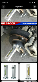

I’ve been incrementally modifying my Z4C leaving enough time between each to feel the changes. I’m beginning to start playing with wheel alignment.
I’m sorted for measuring toe but camber is a little bit more difficult. Does anyone have any experience using spirit level style gauges that measure off your brake discs? £10 off eBay seems reasonable but I’m concerned about the accuracy. Ideally I’d like to be able to measure to within 0.25deg.
I’ve tried the board and phone accelerometer method. That’s like pulling numbers out of thin air.
I’m tempted to make something like a post on a board which can be adjusted to be perfectly level and then take measurements from the top and bottom of the wheel rim. It’ll work but much more faff than the magnetic gauge.

Both of those options will work as long as you make a decent jig to rest on the rim of the wheel and not the tyre as said above. Essentially all you are doing is measuring wheel rim angle relative to true vertical. Measuring the camber from the disc/hub like in the photos above is wrong and will give you an incorrect value once the wheel is reattached the the car lowered. Essentially you could make a jig similar to this:
