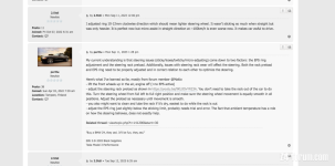

There is an article suggesting the preload on the actual steering rack is the culprit in some cases. https://z4-forum.com/forum/viewtopic.php?f=3&t=100725&p=2028219#p2028219
