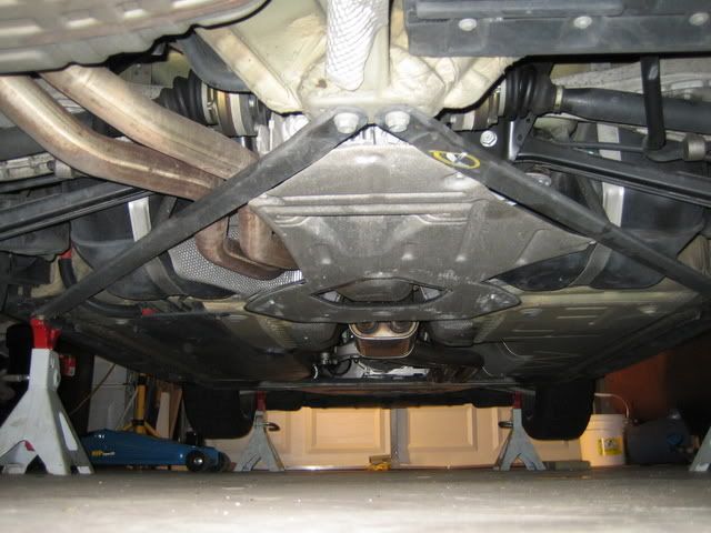

first you need to put your car in the air. ALL 4 wheels and needs to be leveled. I jacked the front end first, each side separately. once one side was in the air, i put the jack stand on the front control arm since i could not find a suitable place to put the stand. for the rear, i jacked it up from the differential where the two bars come together(you can identify them by the two silver screws that are visible from the rear) then once it was lifted, I put two jack stands underneath the proper jacking location. **please pay great attention when jacking up the car and putting it on the stands. CAR MAY FALL if not done correctly.**
