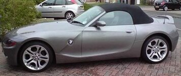

Al, do you have any before and after pics?
Yep i do,
Before.
After.
:thumbsup:
That looks miles better, always thought some Z's look like they sit a little too high ? like yours in the 'before' picture for example.
