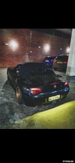

I've got Carly BMW and have the bulb checks off at the moment so I assume that's how it should be to then run LEDS.
I have 501 Amber LEDs to go in the side lights at the front to match my signal DRLS I currently run.
I also purchased LEDs can bus error ones from a site and they are super and haven't flagged any bulbs errors as shown here.

"CANBUS" LEDs will use a load resistor to mimic the resistance of a standard bulb and prevent the bulb checks. For a W5W LED that's at least 4W in a very small package with no cooling.
Depending on the package, for the reasons above, they may well not last.
