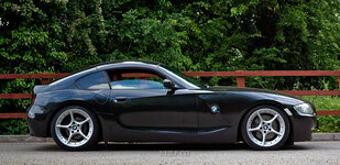

Running v2's on my coupe.
Huge upgrade over the factory setup (covered aprox 34k)
Can't utter a word bad about them (usual build quality that one would expect from kw, nice and comfortable etc)
Not really looked into the Bilstiens mainly as I ran KW V2's in my previous car and it worked well enough for me to go back to their kit again.
Regarding rubbing, 225/35/19 & 255/30/19 on 8j/9j respectively results on no rubbing at the rear and only at the front if I hit a dip in the road too hard. No rubbing under hard cornering though.
No trouble with normal speed bumps, although I did nearly beach it on a bump in Waterloo.
Some pictures:
9019568742_791c47bc5b_c.jpgProfile by NeilllP, on Flickr
9019555078_35aee7bbcf_c.jpg162. Getting low. by NeilllP, on Flickr
12123429716_8cbe9db874_c.jpg24/365 Complain and ye shall receive. by NeilllP, on Flickr
