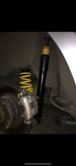

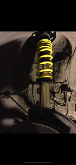

Do you have any update on how the coilovers fared over winter?

Coilovers lasted fine through the winters.
