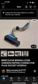

I’ve gone and bought the latest iteration Creator 410 and it’s showing a 98EB error code. Photo below.
Having searched the forum and the wider web, surprisingly few hits. It clears, may stay away for a restart or two but more often than not reappears immediately on start up.
Anyone wise on where to start? Seems the error is for Drivers side door airbag? Nothing to do with me moving the passenger seat?

I 100% had this code and it was inconsistent.
It was slight corrosion in the door connector. A spray with contact cleaner solved it

It’s the multi plug that sits in the a pillar covered by a rubber thingy and trunk.
8mm bolt holds it in the door frame, pop it off by levering it up, then you can see the plug which is a slide type, very similar to those under the seats. Pop a screwdriver into it to unlatch the mech- clean and spray contact cleaner into it

Had a moment to give the door connector a blast with contact cleaner this afternoon. 30 minute job including waiting 20 mins post battery disconnection and it appears to have done the job :driving: :thumbsup:
Multiple restarts today and the pesky light hasn’t returned so far, glorious…for now :rofl:
