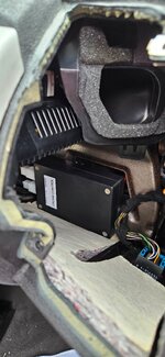

Ah yes I was looking on real Oem and saw that tube, interesting. I meant the main hvac ducting for the event above the stereo though. The large oval output. Number 8….

Does anyone know if the central vent ducting discussed above can be manoeuvred so the amp might go just below the top of the dash where the nav screen would sit?
Also I don’t think removing the dash trim would help me at all for any positioning?
Thanks
Can't help with the venting but removing the dash trims is pointless as it's solid behind them.
