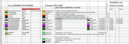

I have the same Pioneer SPH-10BT, If you bought parts from Crutchfield they will help you with your installation problems. On mine I needed to run a 10 wire line to the rear and splice in on the out side of the amplifier. They sell the 10 wire cable at Crutchfield.
