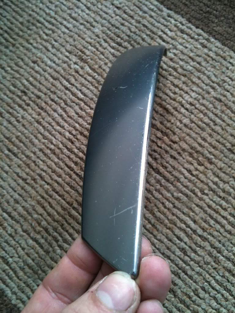

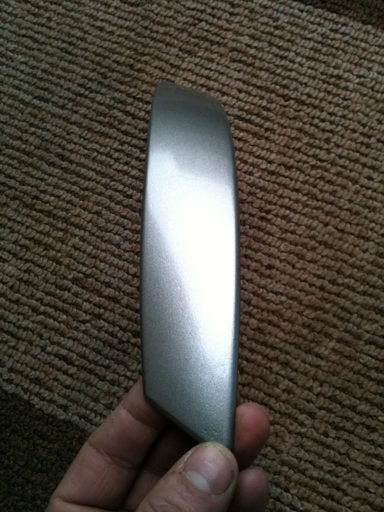

Hi guys i repainted mine using a can of plastikote pewter Finnish then a clear lacquer over the top , not a complete perfect match but you would have to look very hard to notice the difference.
Before painting
After painting
A little tip your domestic oven set at a very low heat is perfect for backing the paint on but dont tell the misses :D
Yeah this is the way to go. Although like I said in a previous post the stock finish on the handles is kind of matte, whereas your resprayed one is quite glossy. I guess there's no clear coat on top of the stock finish, so the question is how long would one expect paint to last without the protective clear coat on top?
You could try using a matte finish silver with a few light coats of clear laquer over the top. Wont be 100% matte but i'd imagine you'll get a pretty close finish to OEM with that method.
