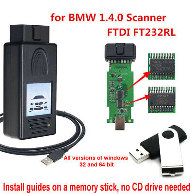

Read the codes. Had a similar issue with a facelift and it turned out to be an issue with the rear left light red LED bar across the top. Had a high resistance, but everything was working ok. Somehow it affected the indicators and made it think there was a bulb out. I used Scanner 1.4 to code out the checks to the rear light and it all started to work properly again.

Thanks, i'll look into BMW scanner 1.4 and probably get a Carly whilst I'm at it.

If you get the scanner 1.4 you won't need Carly.
Here's the link to the one I got.
