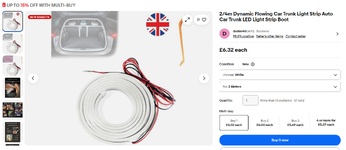

I hop on ebay and spot this 2m LED strip:
Turns out that 2m is exactly the length i need for the G29 boot. So order it up.

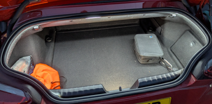

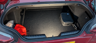

Before:
After:
Highly recommended.
