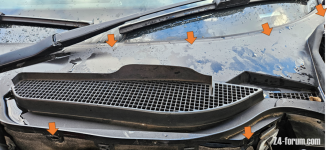

1) I unclipped all the clips in the positions (roughly) indicated by the arrows
Note: these are really brittle....be careful

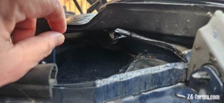

2) I then could gain access to the area where the AUC sensor is:

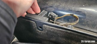

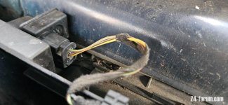

3) I unplugged the negative battery terminal and unplugged the sensor.

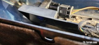

4) You must twist clockwise the old sensor about a quarter turn to be able to remove it. The new one is completely different. It's facing the engine, while the old part was perpendicular to it, facing the passenger's side wing.
5) Once done, refit in reverse order and clear the error code (I don't know if this is necesssary but I did it anyway).
