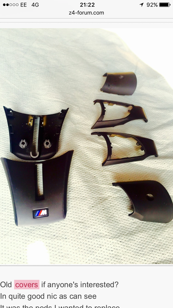

Plastic covers come off very easily
They have screws on the back of them
Can't remember if star or Allen bolt heads
But you don't need to take airbag out
Simply unscrew and carefully pull apart
Lift gently from the edge of wheel and it'll lift from under centre plastic
I replaced mine not so long ago
10 min job taking time to do so :)
Can see the screw holes :)
You will need to move wheel to get left hand side off
I moved mine down to left to access
Ps pods will come out of place if play too much
Need to make sure by clipping in position then doing up screw :)

They my friend are a pain in the arse!!
If remember take time and take pics of the position of them and the damned stupid wiring
Using a screw driver pop the connectors out the buttons are then just held by the covers
Ps, if not reposting buttons, why taking off?
Trust me pain to get back in !

Part numbers on back of buttons :)
Just replaced the covers but unlike dawg found it fiddly. Next time I'd take the airbag off. The switches unplug easily enough at the rear but I didn't replace them. The part numbers are MFL switch right 61318035324, MFL switch left 61318035323. You can get them for about £150 from Germany but that's still too much for me after paying £120 for the covers.
