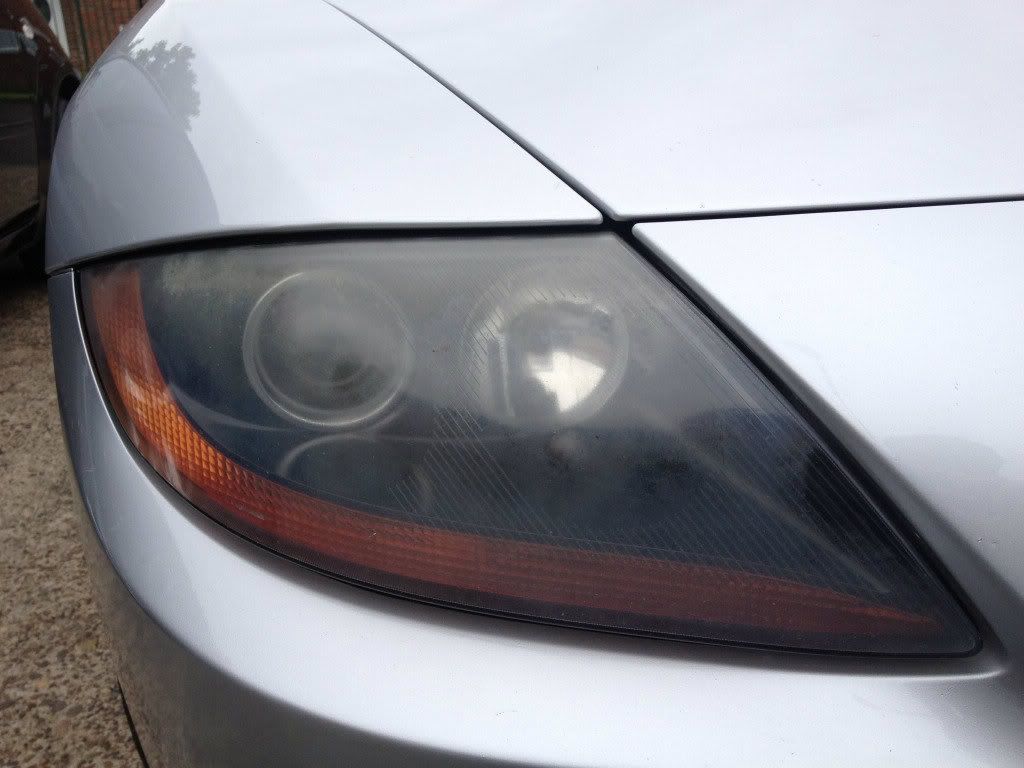

Heres my results:
Before-
After-

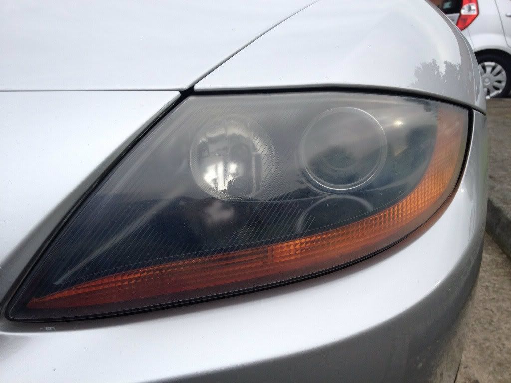

As i have just done my headlights i thought i would add to this
with pics and what i used to do it with,
Easy to follow instructions in kit and don't worry about rubbing the life out
of the lights like i did they don't scratch like i thought they would ( see pic )
before
after
