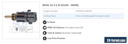

Sensor £32 from GSF there is one in Lincoln
If you remove the undertray you can put the new sensor on the loom and dip it in boiling water to run the fan before you drop a load of coolant on the floor changing it
