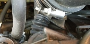

Hi Guys,
How bad is this? :(
Can someone help find the part numbers for this and tell me how to get it replaced?
It's a plastic pipe that is near the lower side of the DISA valve.
I just noticed a hole in it today morning while inspecting the engine. :headbang:
Common problem. Chuck some tape around it for now. Or get a replacement from BMW.
Easy enough to change. Just remove the airbox and pipes and it's just a few jubilee clips to remove and replace it.

Ok. Thanks.
What is the name of this part? What do I search when finding the replacement part?

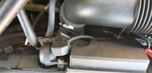

Replaced it today; around 90 minutes job. Tightening of some of the screws is tricky. :D
Also, checked the DISA valve.
