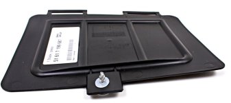

Went over a speed bump yesterday at low speed but still grounded. It's a flap or cover for something. Had to stop on dual carriageway 5mins later as it was grinding... It then fell off and I retrieved it luckily.
What is it?
And what is my next best course of action? Car does seem fine though.

that is the flap that covers the oil drain bolt on the sump :thumbsup: just screws back on, im guessing you might need a new screw
That appears to be the oil drain plug cover/hatch. Used to access the drain plug when changing the oil. There should be a plastic screw where your thumb and forefinger are, which holds it into the rest of the undercarriage tray. 60 second fit (if you can jack the car to get under it). Must have been one heck of a pot hole to dislodge it but at least you didn't lose it.

It is indeed the access cover for the oil drain plug :thumbsup: e879345dd85debd00ae47c51aae8f036-500x500-crop.jpg
It fastens into a spire clip with a special half-turn spring-loaded screw.20190608_102452.jpg
