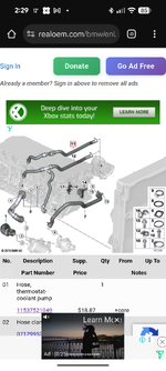

I saw people complaining E85 N52 auto tranny radiator are expensive and difficult to find as it has an extra connector at the bottom of the exit side, just replace #12 to #11 part number 11537519494 then you can use any E46 auto transmission radiator that is cheap and easy to find.
On some US N52 model, no matter manual or auto, they didn't even come with neither #11 or #12, so I don't see how it will affect the performance or how the engine runs.
