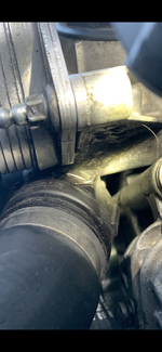

The main pain is that I could see evidence of some sort of oil leak/buildup underneath the oil cooler/oil filter housing:
I’m pretty sure I had cleaned this before reinstalling, so thinking it must be new - which is a huge bummer.
Weirdly there was also a couple of flicks of oil that has somehow made its way to the air filter box too:
I have a horrible feeling I may have over torqued the oil cooler… the YouTube video instructions I was blindly following said 22nm, but having Googled around I’m seeing 16nm mentioned instead.
Is that what’s gone wrong?
And if so, can I simply loosen the bolts so that they’re 16nm? I’m REALLY hoping that’s the solution, rather than needing to start the whole job again!

It doesn't look like the sort of housing that will distort if over tightened and 22Nm isn't the end of the world. It's a shaped O-ring from memory and that won't be affected.
The only real reason for seepage (assuming the gasket is in properly in the first place) is a bit of crud caught in it when putting it back together. This seems unlikely as you seemed to be uber-precautous. Go and watch a mechanic for an hour; they wouldn't even wipe it with an oily rag!
I'd wait and see if it gets any worse, it's probably just slime that's pooled.
As above, very much doubt that the small difference in torque will have affected it. Could just be residue that has now got hot and run down after you did the job.
The flicks on the airbox simply suggest a bit has dropped onto the belt while it's running.
Give it a good clean and see what comes back.

Was kicking myself about going wrong somewhere last night, but you could be right…I did spent a lot of time trying to clean the front of the engine, so it feels possible that I’ve just disturbed some sludge somewhere and it’s ended up on the belt. Not sure how else it would end up on the underside of the oil filter housing and air box!
Regardless, I’m thinking it might make sense to loosen the bolts for the oil cooler a little, and make sure they’re torque to 16nm - better safe than sorry.
I’ll clean it up, keep an eye on it and see how it goes.

Happy to say it looks like the oil sludge didn't return. Took it out for an extended test drive yesterday and seems all okay this time around, so looking like it might just have been a little bit of loose sludge that the belt flung around, which is a relief.
Will keep an eye on it but thinking it's all good!
