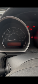

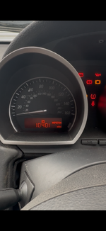

bigwinn Elite Lincoln UK Site Supporter Jun 3, 2026 #21 If you put a cluster in that isn’t native to the car it will throw a mileage tamper dot which will disappear when resolved If that ‘fixes’ the issue you can then either implant your eeprom chip into the new cluster or recode it
