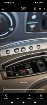

I get the car running and I press the button to lower the roof
I hear the motor in the boot and the windows go down slightly
The roof unlocks from the windscreen and starts to go back
It only get to open about 12” / a foot then it just stops and the motor stops
When you look at the button it is flashing red
Now when you try to press it again it does nothing ????
When you try to press the close button it does nothing ????

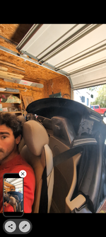

Now going back to when I try to open the roof and it stops I have to go into the boot and pull the red tab ( sorry don’t know the official name of it ) and turn it 90 degrees to lock it into position and then I have to manually push it back down to have it open , I then turn the red tab and push it back in.
Now when I try to get the roof back up by pressing the button it seems to do nothing when it is fully back, so again I pull the red tab and pull the roof back up then start the car and press the button for the last bit and it locks to ?????
Now I don’t know if it’s worth mentioning but the motor is just in the boot not attached to anything ( I intend on using some cable ties to secure it to one side ) and didn’t know if this could be causing it not to work properly ????
