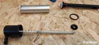

  • Here is how things look when coming appart:
    And the spring out of the unit for reference:
Here is how the unit is put together and works:

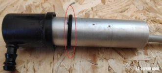

  • There is an outside metal cylinder, pushed into the base and sealed with an o-ring that gets clamped when the whole unit is pressed together. Clearly there is clamping on that o-ring and it is a static part so little risk of leak there:

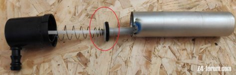

  • There is an inside feed and piston which acts as a pressure relief valve. Basically the water comes from the inside white tube, pushes with the help a spring the white piston out UNTIL it runs out of travel and the main piston (the black one that comes out of the bumper) carries on going out and lifts from the seat (circled in red) which lets the water go out and through the nozzles. The rubber seat is also not a leak source as it is purely internal and has spring pressure on it when not in use:

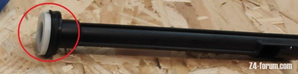

  • Last and most important is the main piston, the one sticking out from the bumper. It rides on the white internal piston and seal in the metal cylinder with a bush/seal combo like a hydraulic piston. This is where mine what leaking :headbang:
