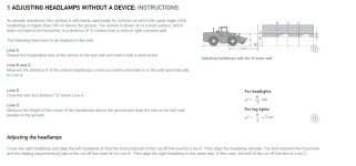

https://www.hella.com/techworld/uk/Technical/Automotive-lighting/Headlight-adjustment-835/
The section 2(5) and 5 is interesting.
Wondered what that was cast into the lamp housing.
Think i will check my beams on a white wall at work with my trusty tape measure.
Simply method would be my 3 foot spirit level. On a flat surface measure height of beam at the lamp, go back 10m and measure beam height.
