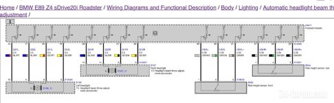

Hi Ron. I would suspect that a headlight level sensor on the suspension has probably given up the ghost. Is your Z4 an E89 and what model/year of 335 do you have ? Do they share same/similar parts ?
Si
Ron, I think listening to Radio 2 was the problem. :tumbleweed: :rofl:
The FRM controls it..as Patriot66 says it probably the front or rear sensor that’s failed. :thumbsup:

I was out in the car tonight and the system now only dips the main beam - prior to the ! Warning main beam would swish to one side or make a “hole” in the beam pattern.
Update:-
The car went into have this sorted today and I've had a call to say it is a module in the LH headlamp unit.
Of course they don't stock a lot of spares in this day and age so it will now be ready tomorrow .
I don't know what the invoice will show but fortunately the BMW insured warranty will cover it :thumbsup:
Update 2:-
New module installed but they tell me that they can’t get the module to communicate.
They are supplying me with a 2 series tomorrow as BMW Tech are now involved,
Nothing is simple :thumbsdown:
